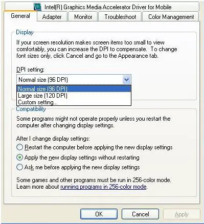

Need a tool to adjust DPI to Xp Windows
Ok so today I found some applications were not running properly on my computer.
Images were shifted, too big, too small and issues like these.
One of the software recommended I should adjust my DPI so the application will function well.
So then I though you guys will be able to tell me or recommend a tool to adjust DPI to XP because I have searched online and nothing. Settings are as they are.
Thank you in advance.

Hi!
The DPI settings can be changed as you wish, since they are sharpening the images you see.
In order to change them, you must right-click on your desktop, then go to Properties, Settings and select Advanced.
There you have three options: Normal size (96 DPI), Large size (120 DPI) and Custom settings.
By default, the normal size is selected, but I would recommend you to select the large size and see if the problem is solved.
Don't forget to reboot your computer after you change the settings and then you can see what happens.
Good luck!
