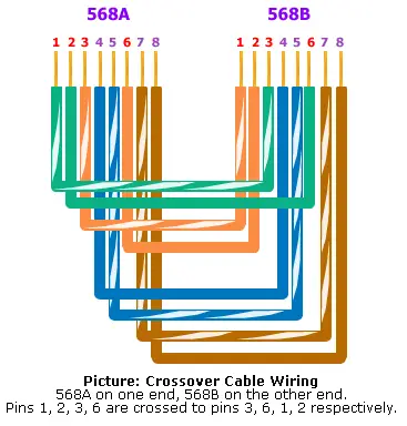

If you want to connect two computers only and form a simple local area network, you need to use a crossover cable instead of the standard network cable. The normal network cable is technically called a “straight-through cable” where the cables connected to each pin on one end goes straight through the respective pin on the other end.
The cable on pin 1 will go straight to pin 1 on the other end. The straight-through cable is the kind of cable normally used in local area networks with three or more computers connected. The crossover cable is configured to work differently with a straight-through cable because in a crossover cable, the connection of some pins crosses over to another pin.
Crossover cable wiring
Unlike with a straight-through cable, you cannot use a crossover cable to connect a computer to a hub. The crossover cable is specifically designed to connect or network two computers only. If you have a crimping tool and you know how to connect an RJ45 connector to a cable, you can follow the diagram above for proper configuration of the pins.
