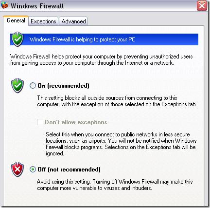

Make sure that your computer firewalls are turned off to make sure that they can connect to each other once you have set up anything. Then start sharing your files.

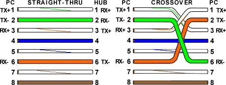

What you actually need to have this done is to use a crossover cable.
crimping the crossover cable that is lengthy enough to connect both laptops

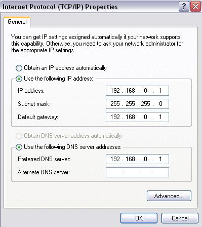

If you are familiar with crimping Ethernet cables, then this won't be so much of a problem to achieve. After successfully crimping the crossover cable that is lengthy enough to connect both laptops, configure each laptop’s IP address as follows;
Laptop A
IP Address: 192.168.0.1
Subnet mask: 255.255.255.0
Gateway: 192.168.0.1
Laptop B
IP Address: 192.168.0.2
The rest (DNS) server’s aren’t all that useful unless you want to connect to the internet. The next thing is to install the printer as a local printer on laptop A and share it. Then Add the printer, as a network printer on laptop B.

Lastly, make sure that you turn off the firewall from both laptops, and you are done.
