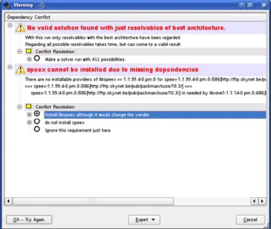

I am attempting to install OpenSuse 11.1 on my Windows 7. After that I received an error message which you can see in the below attached image. Did somebody practice this error early? Need assistance please.

To resolve the first dependency I would suggest to resolve the conflict by selecting Radio for “Make a solver run with All possibilities.”
To resolve the speex package dependencies go with the default option to install the speex package from other vendor. If you do not intended to install it from another vendor skill the installation of speex by setting the second radio option. I would suggest first to try installing the application by ignoring the requirement, only if that does not work with the lower version dependencies than install the application with a different vendor install.
