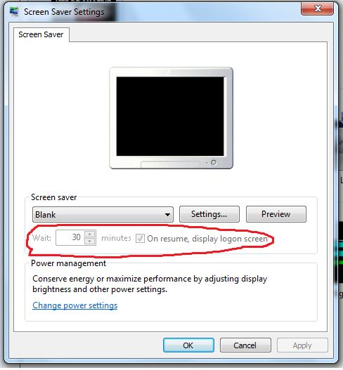

I am facing an issue in which the option to increase the wait-time for my computer getting locked is unavailable or grayed out as shown in the screenshot. One of my friend said that it might be due to a Virus in my computer. I’m on Windows 7 Enterprise OS.
Can someone suggest any patch or fix for this problem.

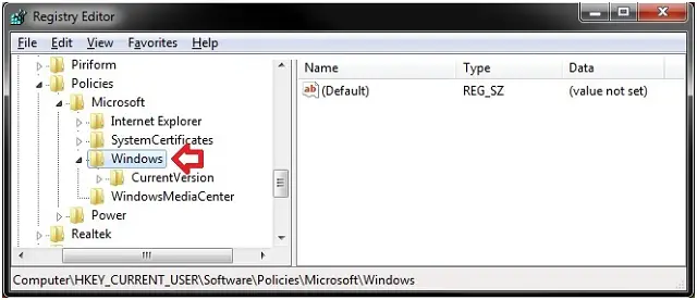

A)   Click on Start menu –> Open the Run prompt, type Regedit, click on OK
In Registry Editor, navigate to the location below. (see screenshot below)
HKEY_CURRENT_USERSoftwarePoliciesMicrosoftWindows

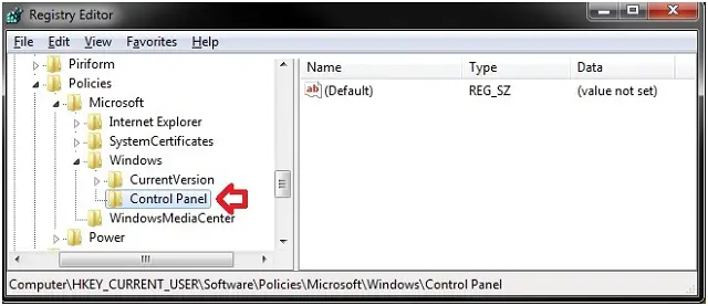

Then click on Control Panel

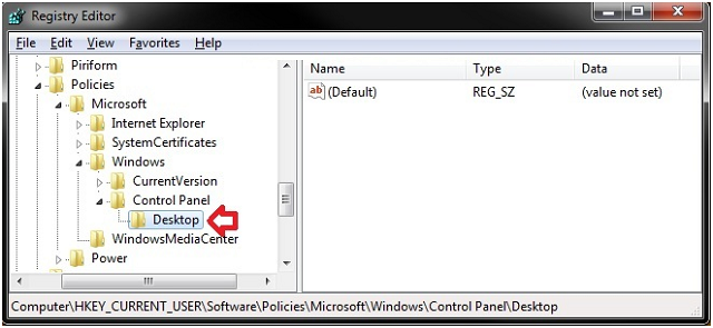

Click on Desktop

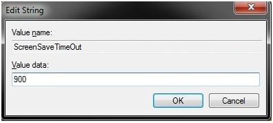

Double click on  ScreenSaveTimeOut.
Type in how many seconds (60 seconds = 1 minute) you want for how much user idle time must elapse before the screen saver is launched, then click on OK. (see screenshot below)
Click on OK. Now you can have a check on the screen saver option regarding the wait time it will change as per the given time in the edit settings
900   = 15 mins
1800 = 30 mins.
3600 = 1 hrs
And so on  u can change the wait time as much as u want.

That doesn’t suppose to happen when you select “Blank” in the screensaver. The options underneath it shouldn’t be grayed out. The only time the options are grayed out is when you select “(None)” in the screensaver because this disables the screensaver itself. If you suspect your computer is infected, try scanning your computer. Update your antivirus and perform a full system scan.
