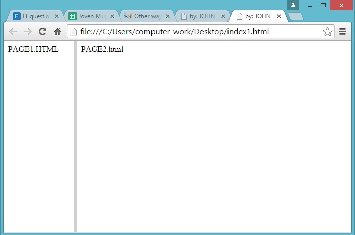

Here is the sample output window:
Here are the codes used.
<html>
<head>
<title>by: JOHN HART</title>
</head>
<frameset cols="40%, 60%">
<frame src="PAGE1.html">
<frame src="PAGE2.html">
</frameset>
</html>
Explanation:
On Line number 6 we inserted frame by using <frameset cols”n,n”>…</frameset> This is to set the frame.
On lines 6-7. We set “src” to the specific web pages that we want to insert inside each frames.
