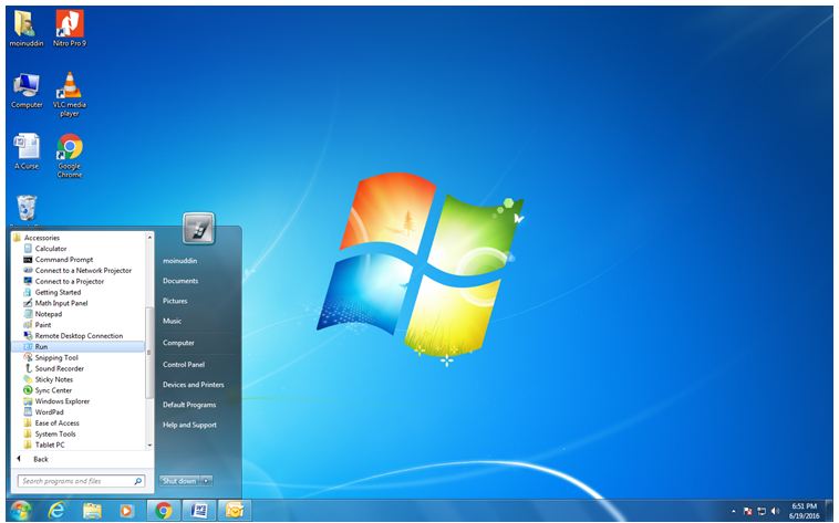

Follow exactly the process below and you will have your work done.
1. Firstly close outlook.
2. Go to start
3.click on accessories and then run.
4.In the run box type, “Outlook /cleanreminders” and hit ok.
You may repair the outlook data file and verify the results and if the problem still persists then a new profile maybe created and then test appointments and check whether work now or not and if they do then you may import the data file that was you used in the old profile.
