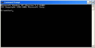

To find a system file causing issues you shall use System File Checker Tool (SFC.exe) which will scan your all system files and to scan here is how you do it –
A. Start/All programs/Accessories/right-click on Command Prompt/Click Run as administrator.
B. If password is set as administrator, enter the password or else just allow.
C. At the Command Prompt (See photo below), type “sfs/scannow” and enter. Scan will start. I think you should not have any problems then.
