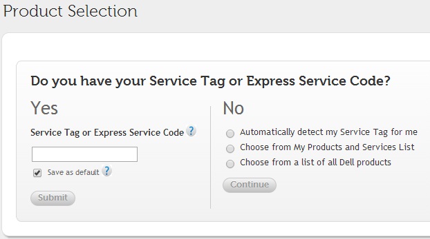

    e. Enter your  Service Tag onto the site to get the needed data from your BIOS. Check here Your Service Tag is on a bar-coded white label  on your computer or peripherals, which is a unique 5-digit or 7-digit  alphanumeric, composed of letter and number  code. Its numeric conversion is an Express Service Code.
    f. Install the system BIOS  from the given site. See the figure below.
