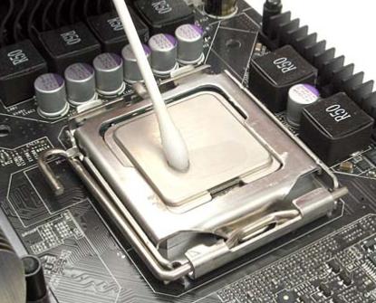

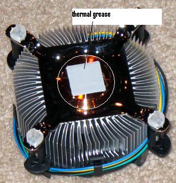

How old is your PC? Did you already check the temperature of your processor? It might be one of the reasons why your computer hangs up during booting. If this is true then all you have to do is remove all the dirt that builds up especially in the exhaust fan,
And also remove the exhaust Fan, to its socket and clean the bottom part of the metal part (Heat sink) and also clean the top of the processor with some cleaning rag, after that put some enough amount to the processor and return back the exhaust fan to its socket.
Now try to boot up your PC and observe your PC if it’s still hanging up. Hope this can help.
