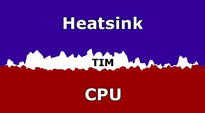

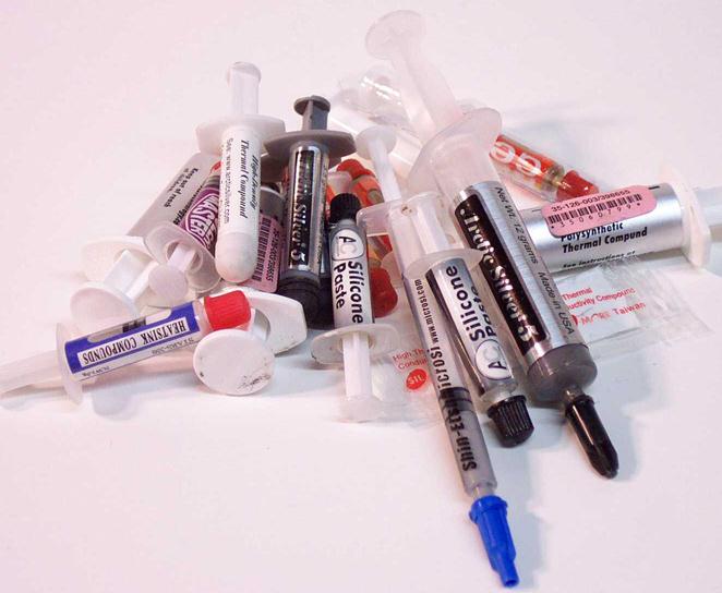

Gaming in general puts a lot of graphic pressure on system's resources and is considered quite a burden on system performance. However, if you have sufficient RAM, and a reasonable processing power, your system should not get extremely hot. Sometimes there is dust in system that blocks the ventilating pores hence trapping the heat but as you have mentioned before it doesn't seem to be the problem. I suggest that you apply some Thermal paste on the system to create a heat sink for your PC. That normally helps in cooling down the system hence increasing the performance. You can see the procedure in the below video.

If you installed a new Processor try Re-Installing the processor chip and Heat sink ,and also apply some Thermal paste on the top side of processor for better conduction of heat to the heat sink, Check the Fan of processor and working normally, if it is making noise by excessive speed than it is sure the problem of heat conduction try changing thermal paste.
