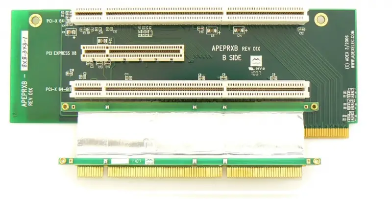

This error occurs mainly due to faults in the following parts
(a) PERC5 controller
(b) PCIe risers
(c) Backplane.
Initial fault testing can be done by removing all the raid drives and then seating them back again. If this does not solve your issue, then consider replacing all these one by one till the problem vanishes away. If you do not have spares then probably this is the right time to stock your inventory for these parts.
