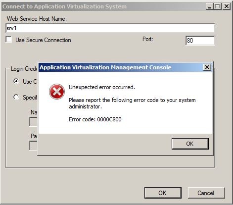

In Application Virtualization System, I am facing the following error all the time.
Unexpected error occurred.
Please report the following error code to your system administrator.Â
Error code : 0000c8000
Any idea will highly appreciated in solving this problem.
There is another alternate available to solve the above error. This solution is SQL bound. Â Please follow the steps and you are done:
1. Go to 'SQL Server Configuration Manager'.
2. Check two things if they are enable or not. (i) 'Named Pipes' and (ii) 'TCP/IP'
3. Please enable both of them.
4. Now you can logon to the App-V Server.
I hope this solution will solve your problem
