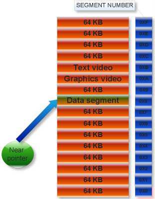

Near pointer is The pointer which cans points only 64 KB data segment or segment number 8 . That is near pointer cannot access beyond the data segment like graphics video memory, text video memory etc. Size of near pointer is 2 byte.

The near pointer is the type of pointer that can only point 64kb data segment. See the image below.
Here is an example of near pointer that will have an output of 2.

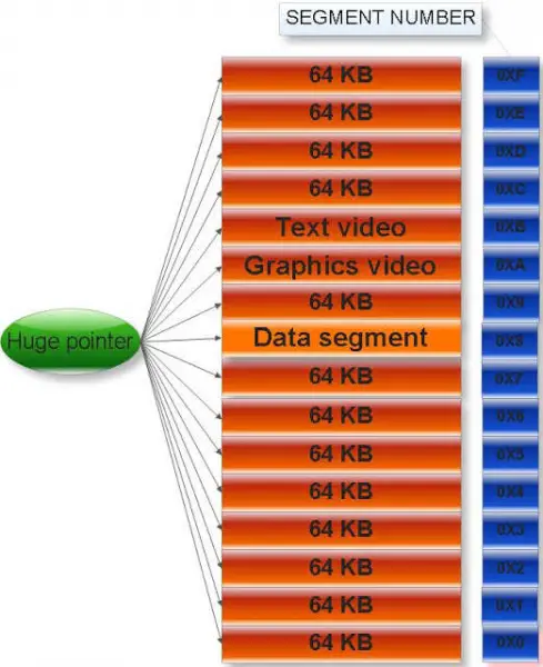

The huge pointer is the type of pointer that can point to the entire 16 segments of the memory. This is similar to the far pointer. See the image below.
Here is an example of huge pointer that will have 4 4 1 as the output.
