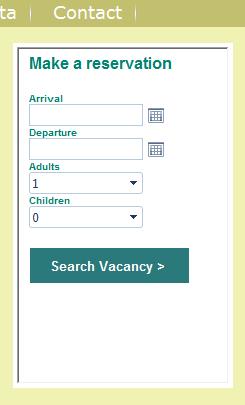

I did experiment using redirection, but it does not solve my problem.
You see, the .Net page is contained inside an IFRAME of the classic ASP 3.0 website. When i use redirection, the destination page (which is a classic ASP page) shows inside the IFRAME.
What i want to do is to open the destination classic ASP page in a new window or as a pop up.
Please see below image. The reservation box is a .Net page inside the IFRAME whereas the main site is in classic ASP 3.0.
As you can see, if I use redirect, the destination page (which is quite bigger that the size of the IFRAME) opens inside it.

Answered By 100 points N/A #89235
Posting data from a ASP.Net Page to a Classic ASP 3.0 Page
I tried out TechnoHat's suggestion; it seems to work!
The only drawback is that the destination page comes up in a big window. I modified the destination page and added more JavaScript code to resize the window. Something is better than nothing!
