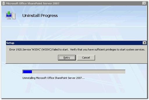

I am using the Microsoft office share point server 2007
I have got a problem during the uninstall process of it.
So please help me with the solution.
Error:
Error 1920.Service 'W3SVC' (W3SVC) failed to start. Verify that you have sufficient privileges to start system services.

Privileges problem during uninstall process
You are trying to uninstall SharePoint and you find that someone has removed IIS first.
 You went on to Add/Remove programs and select uninstall for SharePoint but it fails with an error message “Error 1920.Service 'W3SVC' (W3SVC) failed to start. Verify that you have sufficient privileges to start system services”.
There is no IIS and it can’t start W3SVC without that. Reinstall IIS and then uninstall SharePoint from Add/Remove Programs.

Hailey Paint you saved me.
I followed your steps to verify that I have sufficient privileges to start system services. I reinstalled IIS and everything is perfectly fine.
Thank you very much.
