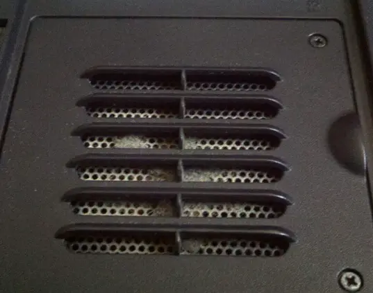

The usual causes of burning plastic smells are covered air vents. While running, your laptop needs to be positioned in a correct manner so as to not obstruct the air vents for the cooler. These are generally located on one of the sides of the laptop (the bigger one) and a few smaller ones underneath.
The ones underneath are equally important. So putting your laptop on a pillow, mattress or any other surface that isn't completely flat would cause your laptop to overheat.

The most common issue with laptops is overheating. The smell you sense could be simply the plastic getting heated.
First, check if your laptop’s air vents are blowing hot air or barely a breeze coming from them.
Overheating Laptops
And if there are dust in it and if its blocking the air to come through make sure you clean it.
Make sure you clean every part of the laptop really well. And carefully. (You may have to remove back cover).
And make sure all the fans are working properly.
And make sure your battery works fine. A bad battery can also make a bad heat.
