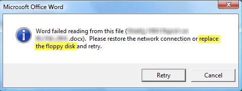

I am using windows 7 OS and when I am trying to open some word files I get a error message.
When I try to open a file it says "Word failed reading from this file".

Is your file coming from a removable media or from a network drive? If the error message is like the image below,:
then try reinserting your removable media or restore your network connection(if file is from a network drive). If the error still persists, try copying it into your hard disk and then open it again.
