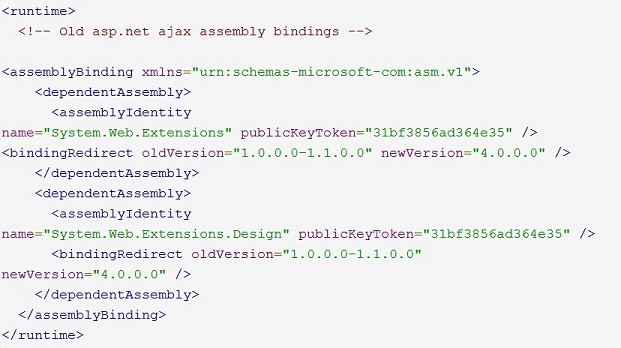

This is how you need to change the settings. Please see the below image which will help you in doing the configuration of web.config file  which all you need to change.
Please let me know if you need any more help.
