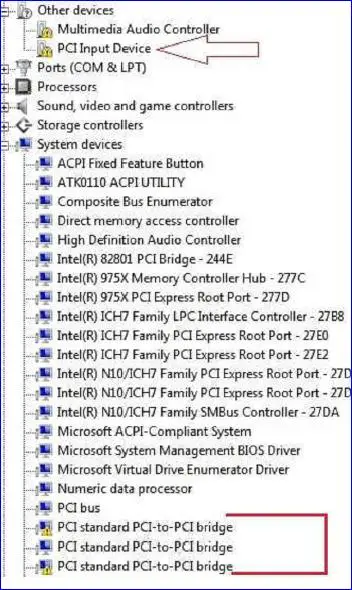

We are currently using Windows 7 32-bit on our computers and are also having trouble getting GS 8400 PCI express and nVidia GeForce 8400 GS PCI video cards functioning at the same time when running multiple monitors. We always keep on getting PCI bridge errors and have tried several solutions to fix the errors including changing PCI slots and others. Before upgrading from Windows XP to Windows 7, we never experience any of these problems. Do any of you have solutions or tips on how to get both cards to work continuously to run 3 monitors at the same time? Any form of help is deeply appreciated.

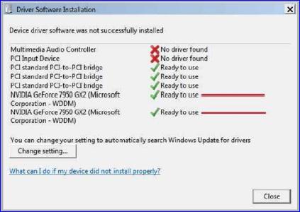

go to MY Computer> system properties>device manager>portable devices>Scan for hardware changes(on the up side tool bar)>follow the image
Install the drives
I show u only one drive How to install it U will install both of the drive
(and it is recommended to uninstall both the drives before u reinstall it )
may be U have got the solution. bye……………………..
