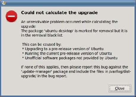

Error:
Could not calculate the upgrade
An unresolvable problem occurred while calculating the upgrade:
The package 'ubuntu desktop' is marked for removal, but it is in the removal blacklist.

The problem is you are trying to upgrade Ubuntu 9.10 directly to 11.04.
This link from ubuntu.com shows what upgrade paths are supported:
https://help.ubuntu.com/community/UpgradeNotes
As you will see from the above link, Ubuntu only supports upgrading from 9.10 to 10.04, 10.04 to 10.10 and 10.10 to 11.04.  Therefore, to upgrade 9.10 to 11.04, you will have to first upgrade from 9.10 to 10.04 then upgrade your 10.04 to 10.10 and finally upgrade your 10.10 to 11.04.
Before proceeding with each upgrade, you should first ensure that all updates for your current version have already been installed.
Kindly check the link I provided since it already contains all the information you will need.
Good luck on your upgrade and post back to let us know how it turned out.
