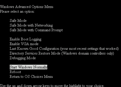

Problem When Turning On My Computer
Once, I also faced this problem. When my windows was not properly shutdown (via Turn Off button). Press F8 and start windows normally. Hope this will work. If not then try to run in safe mode and copy all your important files and reinstall your OS.
