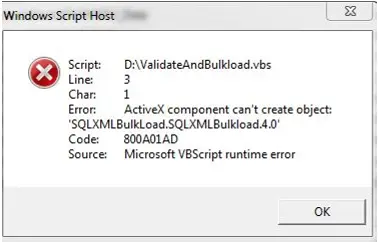

Problem With Creating ActiveX Component, And It Throws 800a01ad Error
Discuss on 800a01ad error? Describe the reason behind the occurrence of this error and give the steps to fix the error message?
The ASP code generate an 800a01ad error code that occurs when the ActiveX component can’t create the object. The cause of error 800a01ad is the VBScript that contains an illegal method, probably a typing mistake or an extra error. the steps to resolve the error code are as follows:
Step 1: Install MDAC 2.x application.
Step 2: Register \program files\common files\System\MSADO15.dll with RegSvr32.
Step 3: Make sure that IUSR_<Server>AND IWAN_<Server> accounts both have Read/Execute NTFS rights on the following folders:
-\program files\common files\System
-\Winnt
-\netPub\WWWRoot
Step 4: Open Console and check the valid IP Address in “Default Web Site” properties.
Step 5: Reboot the server.
