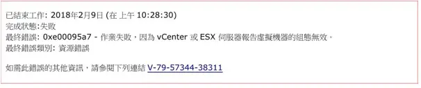

Give a detailed explanation on 0xe00095a7 error? Describe the reason for the occurrence of the error with its snapshot and explain the method to resolve this error.
0xe00095a7 error is a VMware error that occurs when the user backing up the data via AVVI agent. The error message display ‘Error 0xe00095a7 – The operation failed because the virtual center or ESX server reported that the virtual machine’s configuration is invalid.’ The solutions to fix the error code are as follows:
