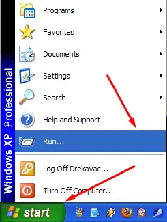

1. Click "Start" and click "Run"

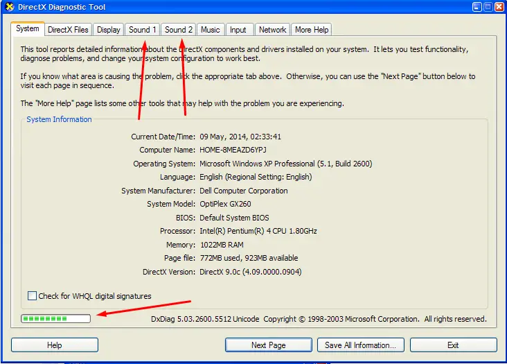

2. Run dialogue will appear. Type in dxdiag and click OK

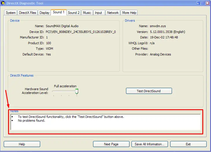

3. DirectX diagnostic tool will launch. Wait for the progress bar to disappear and then click the "Sound" tab.
4. A window with detailed information about your sound setup will appear. Pay attention to the "Notes" section below. Any problems the diagnostic tool has detected concerning sound will be spelled out here. In this case, there are no problems.
5. Write all information about problems from your "Notes" box down. If there are several sound tabs (Sound 1, Sound 2, etc) click on them all in turn and repeat the process.

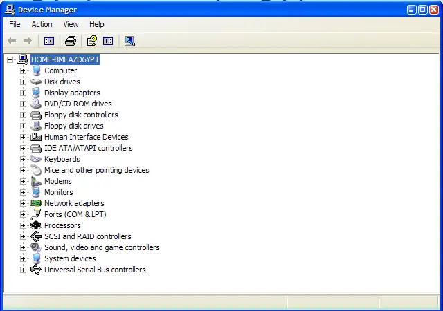

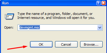

6. Now you will open another diagnostic tool from your computer and check for more information there. To do this, again go to "Start", click "Run" (similar to step 1.) but this time type in devmgmt.msc and click "OK".
7. This will bring up the Device Manager. Here you can see every device and driver installed on your computer. Any problem the Device Manager detects will be marked with a yellow exclamation or question mark. Exclamation marks represent serious problems which impair the functioning of the device, while question marks mean minor issues which do not prevent normal functioning. In this case there are no problems.

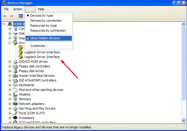

8. However, if "View" option is clicked and then "Show hidden devices" is clicked, another set of devices will appear.

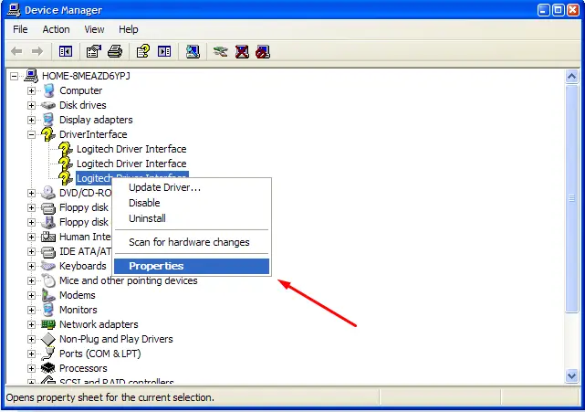

9. Any of these entries can be right clicked and the context menu will appear. Be careful when working with the Device Manager, since it is a powerful tool that can completely disable normal operation of your computer with a couple misclicks. Find a problematic entry, right click it and click "Properties".

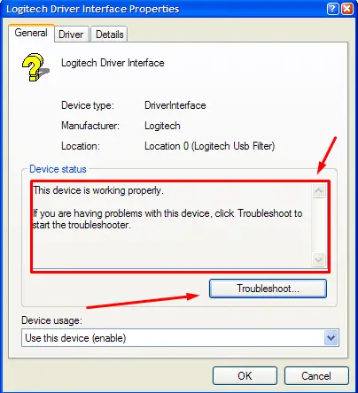

10. Device Properties window will open. Note the "Device status" box, which will show information about problems (if there are any). In this case, the device (Logitech mouse) is working properly despite the question mark. Check all problematic entries in your Device Manager by using this method and write down all information from "Device status" boxes. You may click "Troubleshoot" in an attempt to resolve your problems that way.
