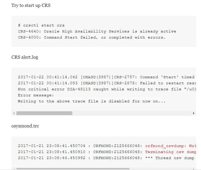

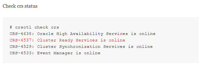

Check the CRSD record and also check the alert log for all the alternative details. Also, make a note if CRS is running or not. Check whats with the status of ora.crds, if it is offline then try again starting CRS ora.crsd.
crsctl stat res -t -init
crsctl start res ora.crsd -init
