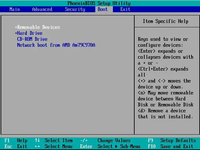

2. Restart your laptop.
3. Wait for it to turn back on and if the laptop starts to boot, hit ‘F1’ or ‘F10' button to open the BIOS screen.
4. At this moment you should now on the BOOT menu.
5. USB/ drive should be the first boot device instead of HARDDRIVE.

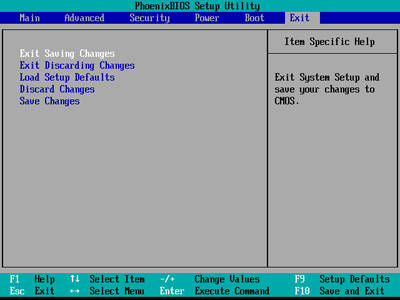

6. After that make sure that you save the changes and then exit.
7. The installation will start from your FLASH DRIVE if you did everything right.
