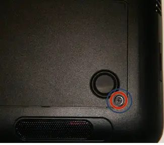

Here are the steps to remove the hard drive:
1. On the back side of your laptop, remove the screw at the bottom right corner.
2. Pull up the back case by using a plastic tool.
