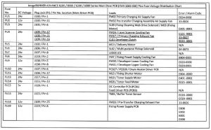

There is a list of a various error code which associate and fuse with:
And the most important error code is E808. This comes through above machine. There are layers of dust present in everywhere filters, fans and every month this error fail. This all error codes will be very helpful for you and remove all bugs.
