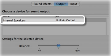

  • Open the System Preferences from the main menu.

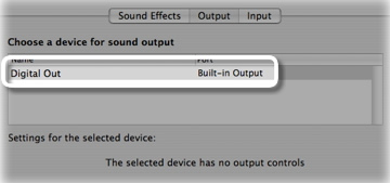

  • Select internal speakers after opening the sound panes and output tabs. You can also increase the speaker volume.
  • If you cannot the locate internal speakers tab in the output tab, then select the digital out if your computer is not a Mac Pro.
