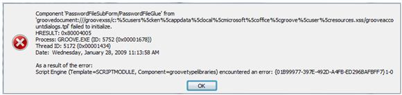

I have an issue here that needs some help from you experts. I met an error while doing my documentation work under Microsoft Office Groove. I pasted below the whole screen shot of the error message for a better view of my problem.
Component ‘Password File Sub Form/Password File Glue’ from
‘groovedocument://groovexss/c:%5cusers%5cappdata%5clocal%5cmicrosoft%5coffice%5cgroove%5cuser%5cresources.xss/grooveaccountdialogs.tpl’ failed to initialize.
HRESULT: 0x80004005
Process: GROOVE.exe (ID: 5752 (0x00001678))
Thread ID: 5172 (0x00001434)
Date: Wednesday, January 28, 2009 11:13:58 AM
As a result of the error:
Script Engine (Template=SCRIPTMODULE, Component = groovetypelibraries) encountered an error: {01B99977-397E-492D-A4FB-ED296BAFBFF7}1-0
Looking at the error message above, I can't understand what is stated. Since I am just a plain computer user, I don't have any technical skills to solved this issue.

Dear,
Based on your trouble description, I believe this issue could be triggered whenever your own Groove connection treatment is already damaged. Thus according to this scenario, let's refer to these measures and after, test the outcome.
  • Shut down the actual Groove.
  • Start->Run and also sort cmd and push get into.
  • Inside control line, you should get around in order to c:program filesmicrosoftofficeoffice twelve
  • After that, type grooveclean and also media enter
  • After these kinds of measures, let us reactivate the actual Groove to check the results once more.
Many thanks.
