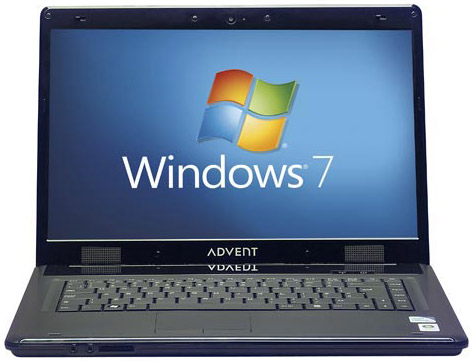

The right click button on my laptop has stopped working. I checked the control panel settings they are ok. Using an Advent Roma 2000 with windows 7.
Any ideas on how to fix?

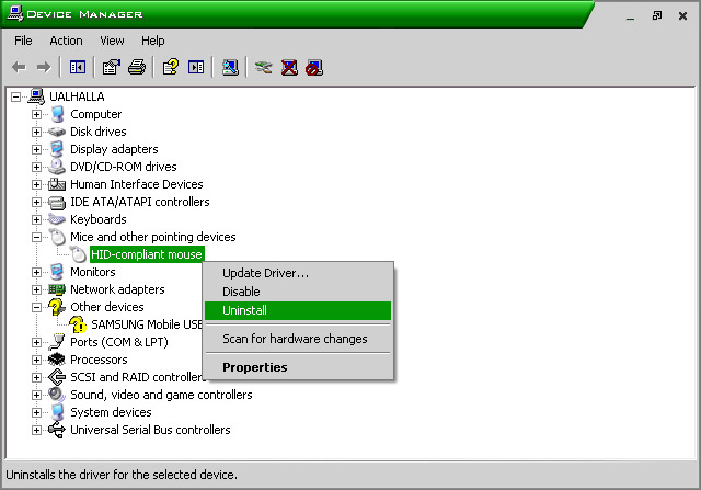

Since the problem is with the right-click button of the touchpad of your laptop, try reinstalling its driver. You need to uninstall and then install back the driver to possibly fix any corrupt files. But first, download the touchpad driver from ADVENT Roma 2000 (I50IL1) Touchpad Drivers. Agree to the terms by checking “Check box to agree to terms and conditions” then click “Download file”.
This is, by the way, done on Windows XP. Since you are using Windows 7, just adapt the instructions on your computer. Once downloaded, click Start, Control Panel, and then “Add or Remove Programs”. Scroll down and select the touchpad driver then click Remove or Uninstall. If it is not listed among the programs, right-click My Computer then select Properties. Select Hardware tab then click Device Manager.
Expand “Mice and other pointing devices”, right-click on your touchpad, and then select Uninstall.
When uninstall is complete, restart your computer. Next, when Windows detects your touchpad and prompts you to install its driver, run the installer you downloaded then test your touchpad afterwards. See if this fixes the problem. If the touchpad doesn’t have any problem physically, it should work after installing the driver. But if not, you probably need to replace your touchpad.
