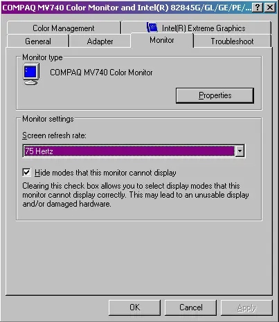

Because your screen blacked out after changing the resolution, I think it is not only the resolution you changed but you also changed the monitor’s refresh rate and that can dearly damage the hardware. When you install the video card’s drivers, by default, it will disable the refresh rate values that can harm the monitor. Here’s how to check your monitor’s refresh rate.

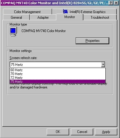

Click Start, Control Panel, “Appearance and Themes”, and then select Display. Select Settings tab then click Advanced. Select Monitor tab. Here, under “Monitor settings”, the safe refresh rates that your monitor can support are listed under the “Screen refresh rate” dropdown list. Shifting to any of these values will not harm your monitor. Under it, the option “Hide modes that this monitor cannot display” is checked by default.
This option disables the refresh rate settings that cannot be supported by your monitor and can cause damage. If you unchecked this option and then select a refresh rate not supported by your monitor, usually the rate next to the highest safe rate up to the highest, there is the possibility that your monitor may fail. And if this happens, you will end up buying a new monitor.

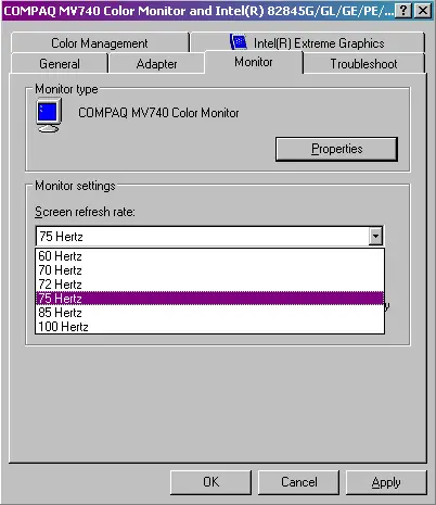

For example, in my case, the safe refresh rates for my monitor are 60Hz, 70Hz, 72Hz, and 75Hz.
If I uncheck “Hide modes that this monitor cannot display”, I will have an additional of two refresh rates that are not supported by my monitor: 85Hz and 100Hz. If I select any of these two, I will be risking my monitor of getting damaged and since my monitor is already old, I might end up with a black screen as well which permanently cripples the monitor.
