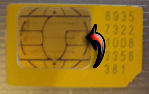

The SIM /USIM card has not been detected or is invalid
This problem happens to me very frequently. If the broadband stick is still working the other day then so is the SIM card. Wireless broadband stick like this one is not that easily to get broken. You can stop worrying now because your mobile broadband dongle is not broken or something if that’s what you are thinking.
The main cause of the problem is the SIM card but I’m not saying that your SIM card is already broken. The usual cause why this happens on wireless broadband modems is when you infrequently remove the SIM card from the modem’s slot. The side of the SIM card that directly contacts to the slot’s connectors attracts dirt.
Dirt develops on the surface of the contacting side that prevents the SIM card from completely connecting to the connectors. You just need to clean this part with a clean cloth to remove the accumulated dirt. Rub the cloth with your finger on the entire contacting surface until it is clean. See image.
You will notice that after cleaning the SIM card and inserting it on the broadband stick, the device will again detect it as before.
