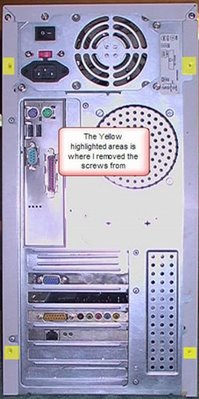

1. Open the case of your 'System Unit'

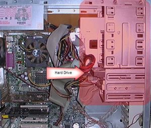

2. Once inside the case of the computer, please locate and remove the hard drive that you need to make into a slave.
A. Remove the screws that hold hard drive in case
B. Disconnect the connector cables from the hard drive

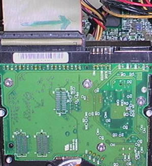

3. Please move and place the small black 'Jumper' as shown below in the picture. The jumper should be placed on the pin that corresponds to the label 'Slave'.
A. Place the jumper pin as shown below
Once you have placed the 'jumper' on the 'Slave' pin, please reconnect your hard drive and boot your computer.
You should be all set now, if the process did not work, please check and ensure that the 'Jumper' is on the 'Slave' pin.
