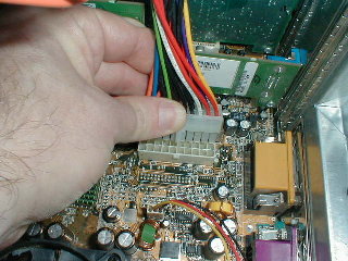

Gurdeep, your problem here is a bit tricky to solve but if you follow these step by step solutions, your computer should be perfect within no time!;
-You first need to disconnect the power cord of the system unit, from the power supply before anything since you will need to disassemble the computer.
– Touch a metal surface to ensure discharging of static electricity.
– Carefully disconnect the 20 pin ATX power connector and the 4 pin ATX2 power connector.
Remove all PCI cards from the computer and disconnect all drives cabling from the motherboard. Disconnect also any internal usb fly leads from the motherboard
By this time what remains is the CPU heat sink and fan RAM memory and video card. Locate the round battery in the bottom right (CMOS battery) and below it you see a jumper cap. The cap covers 2 pins(1&2) with pin 3 bare. Its marked J1. Remove the pins and move the jumper to replace with pin 2 & 3. Leave it for 30 seconds and return back to their original positions (i.e pin 1&2.)
Once you do that, reconnect the 4pin ATX2 power connector and the 20 pin ATX power connector.

It is one of the great problem for you i think if you follow the instruction you can get the idea.
-You first need to disconnect the power card of the system unit, from the power supply before anything since you will need to disassemble the computer.
Remove all PCI cards from the computer and disconnect all drives cabling from the motherboard. Disconnect also any internal usb fly leads from the motherboard By this time what remains is the CPU heat sink and fan RAM memory and video card. Locate the round battery in the bottom right (CMOS battery) and below it you see a jumper cap. The cap covers 2 pins. with pin 3 bare. Remove the pins and move the jumper to replace with pin 2 & 3. Leave it for 30 seconds and return back to their original positions. Once you do that, reconnect the 4pin ATX2 power connector and the 20 pin ATX power connector. Connect also the case speaker. Apply fresh compound to the CPU and heat sink. Reconnect all the other devices and return the casing.
Restart the system to see whether it works. It should work, good luck.
