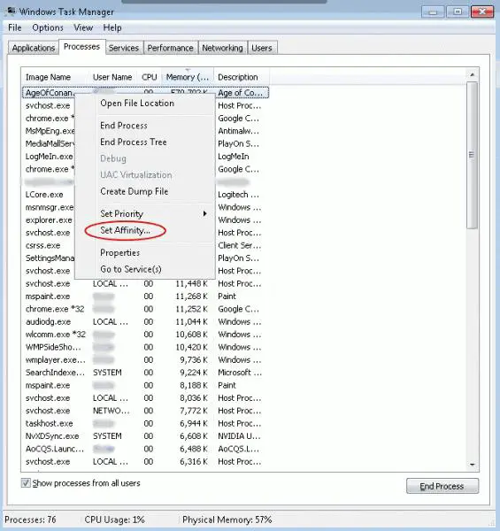

If this doesn't work, disable extra core while the game is running. Start the game and open the Task manager. Go to the Processes and right click, Speed2.exe and select Set affinity.
Remove extra core and click OK.
