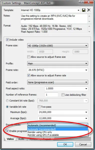

Sony Vegas Encode mode CPU only
This type of error occurred when you have Encode mode: Automatic.
Guide:
File-> Render As-> Customize template and at the bottom of that page you will see Encode mode. By default it will be Automatic and you need to put it as Render Using CPU only.
Enjoy your work.
