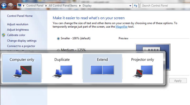

here is another way of doing this by using hardware related stuff. If you can run the projector as a secondary screen, as if they were side to side, then you can drag the PowerPoint window or whatever presentation program window to the projector and carry on working on the monitor, the first screen.
Presentation program window to the projector
But first you must configure your display to do this. This feature is called as ‘Extended Desktop’ or ‘Dual View’. Your graphic card has to support two outputs. If your hardware doesn’t support this you are a bit out of luck.
Anyway if you are using a laptop then you do not need to be worried because almost all laptops treat VGA output as a second socket, which is independent of the integrated screen. And also laptops got a key that can tell where the output must go, laptop screen or the projector screen or the boot.
