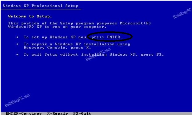

Just press any key and it leads you to a windows installation setup.
Just press enter, and to the next page press F8,
Press enter to start setup

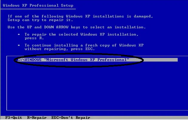

After that you are now on the page where you can see your current windows listed in the list.
Press R in the keyboard and it will now perform a system repair.
Press R to run Windows Repair
Just wait for a while to finish the set up and when it’s done it will restart automatically.
After the cold boot your PC will now continue with your windows, see if the problem is still there.
