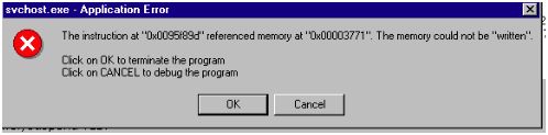

Svchost.exe error referenced memory at '0x00003771'
The instruction at "0x0095f89d" reference memory at "0x00003771".
The memory cannot be "written".
svchost.exe – Application Error
The instruction at "0x0095189d" referenced memory at "0x00003771". The memory could not be "written". Click on OK to terminate the program. Click on CANCEL to debug the program
This happens on my Windows XP machine and not much could be found on other sites. So decided to post a question here

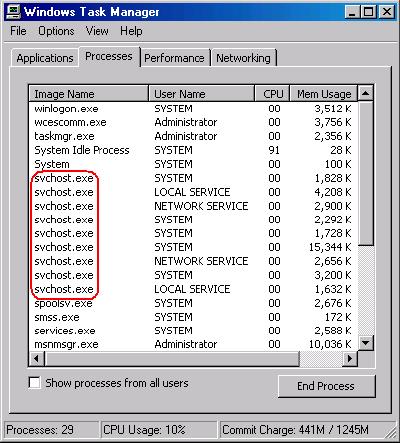

Another Problem That you may face because of svchost.exe is your computer working too slow from the time you turn on your computer where you may not be able to work with any up to an hour. I have faced this problem for some time before. For this what i will do is I will go to Task Manager and click on Process tab to check out any programs occupying maximum CPU Usage.
Because Most of the time I have noticed svchost.exe occupying the maximum number of CPU Usage up to 99% which never allows any of our application to be executed .What I will do is i just right click on the particular svchost.exe file and select End Process. Most of the time this solves the system slow issue.
But actually I do not recommend to do this because sometimes, disabling an important svchost.exe that supports OS may cause the computer to shut down. However, I would like to guide you on how to reach Task Manager to check out CPU Usage .
On Main Screen Press (Ctrl+Alt+Delete) at once.
You may notice a small window,There click on Task Manager
Now you may notice the Task manager window. In that Check for Processes Tab and click on it.
Where you can find a list of files that are Executed .
The Image Displayed below is an example for Task Manager Window with processes tab selected
You can find the CPU Usage in the above displayed image. Where as I said before if that CPU Usage is high up to 99 % or anything above approximately 15% occupied by svchost.exe makes the system to work slow.

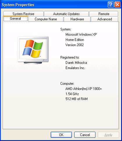

Go to Start Menu and Right Click on My Computer and select Properties
A window named System Properties will get opened. In that select Automatic Updates tab
Select turn off Automatic updates
Restart the computer and allow it to load completely once it is restarted
Access windows update tab once again
Turn on the Automatic Update.
The below mentioned Image is an example for system properties window for reference.
The Image dsThe
This above mentioned step should correct the problem. If it still doesn't work, then we will go to Option 2:
