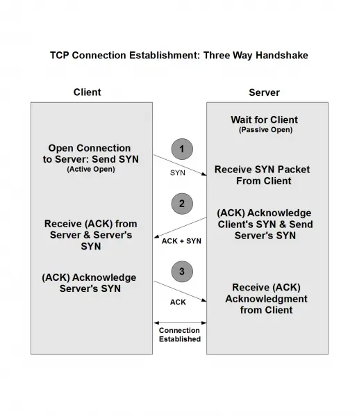

Dear Marc A White,
Thanks for asking a basic but very important question whoever wants to understand networking clearly. As my fellow expert already described you the step by step process very nicely I will not waste too much time of yours. But I just like to add a picture which I hope gives you more clarity on the issue.
I hope above picture will help you in removing any confusion. The picture shows that Client infact sends an acknowledgement to server for full fledge connection establishment.
