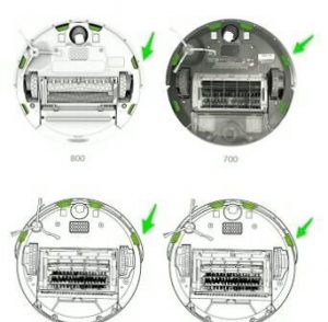

- Error 1: You need to move Roomba to a new location and after that press clean to restart. This happens when Roomba has a side wheel hanging out or when it is stuck. To fix it you need to check the side wheels.
- Error 2: You need to open Roomba’s brush cage and clean it. This happens when the main brushes fail to work. You need to check the Main brushes.
- Error 5: You need to spin Roomba’s side wheels. This is encountered when the side wheel is stuck. You immediately need to check the side wheels.
- Error 6: You need to move Roomba to a new location and then press clean to restart. You see this when the cliff sensors are dirty, and the Roomba is stuck. You need to check the Roomba cliff sensors.
- Error 9: You need to tap Roomba’s bumper to clean it. This is encountered when the bumper is compressed or dirty. You need to check the bumper.
- Error 10: One needs to spin Roomba’s side wheels to clean them. This happens when the side wheel is stuck. You need to check the side wheels.
