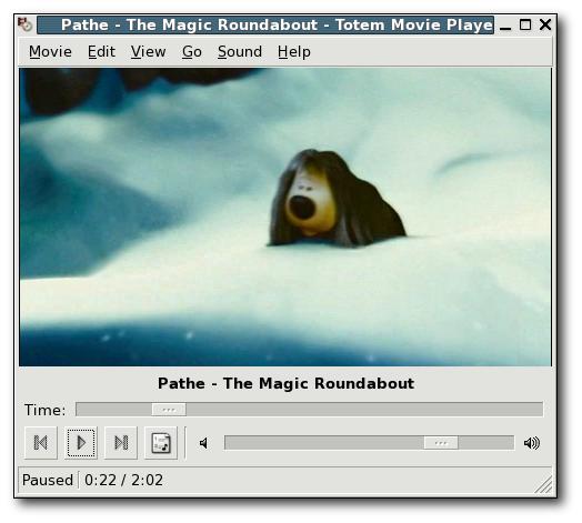

I am using the Totem movie player to play all kinds of files but I got an error message when I try to play AVI videos using the Totem movie player. I just installed the latest version to fix this error but the same error exists. How can I fix this problem? I need your suggestion. Any help would be greatly appreciated. Thanks in advance.
Totem could not play ‘vcd:///media/cdrom0’.
There is no input plugin to handle the location of this movie

Hi Violet,
The error you are getting “Totem could not play 'vcd:///media/cdrom0" it comes only when you play a VCD files to Totem.
And to solve this problem:
You install gxine through synaptic:
Once you open gxine you will get an option DVD/VCD etc
Choose VCD and you have a player that plays VCDs.
The Screenshot below is of the gxine menu.
