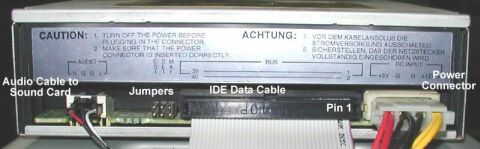

-Make sure that your CD-Rom drive is properly connected. If it was not properly connected then try to connect it by following picture.
-You have to make sure about power supply on CD-Rom driver. So you have to connect the data cable properly.
-Make sure that the jumper is properly connected. Set your IDE channel to master if your IDE channel is bearing one device.
-Have you any SCSI device on your drive? If have any SCSI device then you have to check the SCSI cable, and have to make sure  that your driver is assigned with a unique ID number.
