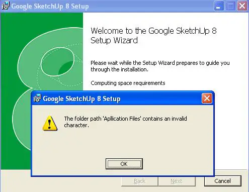

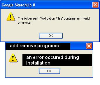

PROBLEM is: While I was trying to uninstall it, an ERROR appears. And when I click the “fix” button, it requires me to browse an .msi file for the reason of reinstalling the program automatically. While trying to install it from the .exe file, a loading screen appears and then an error message generated. Then it says to finish the procedure without reaching the last step of the installation! The folder path 'Application Files' contains an invalid character. Add remove programs An error occurred during installation.

"The Folder Path Contains an Invalid Character" or "Error 1324" is usually caused by an invalid character in the profile of the current user of the PC.
To determine if your user profile contains an invalid character you can navigate to "C:WindowsProfilesYour User profile" check the profile name for any invalid characters. If you find an invalid character your profile may be damaged.
To fix this damage you can either turn off user profiles then run the installation or you can run the installation under another non damaged user profile.
To run under another profile log off and use another user account. and to turn off profiles go to the control panel then User accounts and choose turn user accounts control on or off and uncheck the user account control option then press OK and then try to run your installation again.
