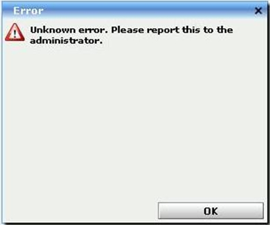

I have installed the Moodle version 2.2 and open meetings plugin. I just created an activity in Moodle so that I may join a room directly in open meeting. The problem started when I tried to access this open meeting activity in Moodle and an error message displayed on screen. Can I get any resolution to fix this issue? I would be grateful to you for any assistance. Thanks in advance.
Error
Unknown Error. Please report this to the administrator.
Unknown Error in Moodle 2 2
The problem was caused by JDK, so you can downgrade JDK version to 1.6, and everything will work.

I was testing Open meetings 1.9.1 with Moodle 2.2 and I had no problem with the connection.
