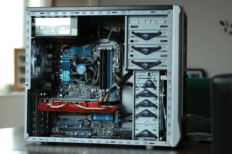

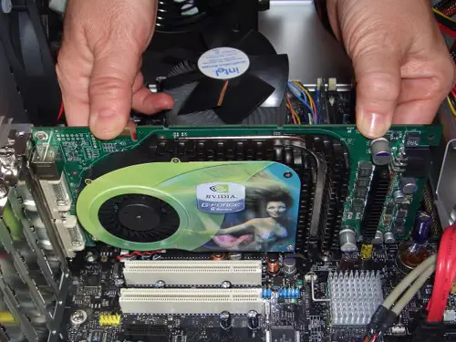

What you can do here is, disassemble your computer and remove the CMOS battery near the system BIOS and also the video card to see whether they could be the cause of the error. Then return them back after several minutes as shown.
Remove the battery and the video card.
