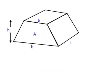

If by the trapezoid, you mean trapezoidal prism, here is the answer:
A trapezoid prism, as you see in the figure above, is a three-dimensional figure, having two trapezoids on opposite faces and these are connected by four rectangles.
The formula to calculate the volume, denoted by ‘V’, of the trapezoid prism, is:
V=1/2 h(a+b)l
Where,
h = height of trapezoid prism,
a = length of the smaller parallel side of the trapezium forming a part of the trapezoidal prism,
b = length of the larger parallel side of the trapezium forming a part of the trapezoidal prism,
l = length of the prism.
