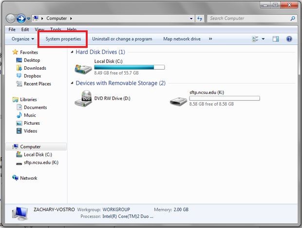

Must have at least 30GB of free hard drive space

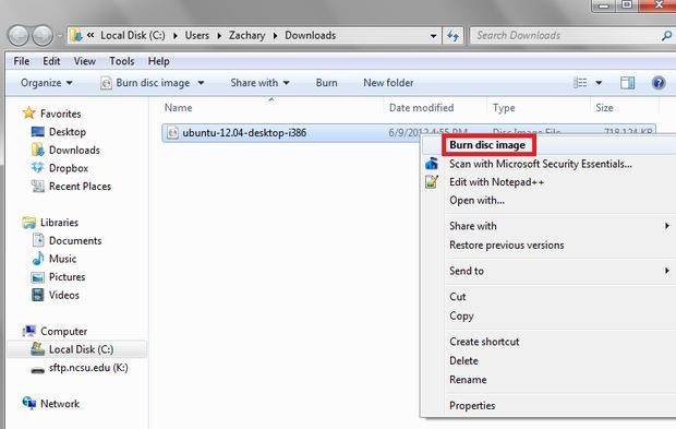

Browse to the Ubuntu website and download it. Depending on your internet connection speed, the ISO take a while to download. After the download is complete, open the folder where it has downloaded. Right click on the folder and click “Burn disk image”. You can burn it onto a DVD for future reference. You can also use a USB, you can use a program called Unetbootin which you can download from here.

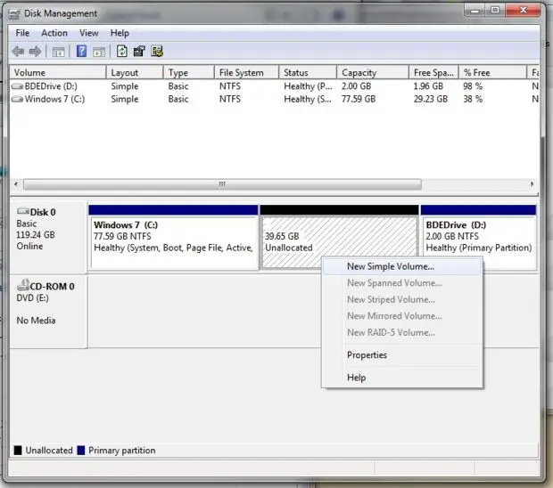

Partition your hard drive using Windows 7 Disk Management program to make your existing windows partition smaller. You will be able to see all the partitions in the window that pops up. On the larger partition, make sure that you have 30G free space. Right click on the drive and select “Shrink Volume” which will take quite a while to complete. When it prompts you for the amount of MB you would like to shrink your drive by, select 30G (this is over enough space for installing Linux). Click the Shrink button

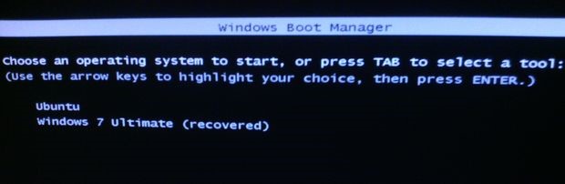

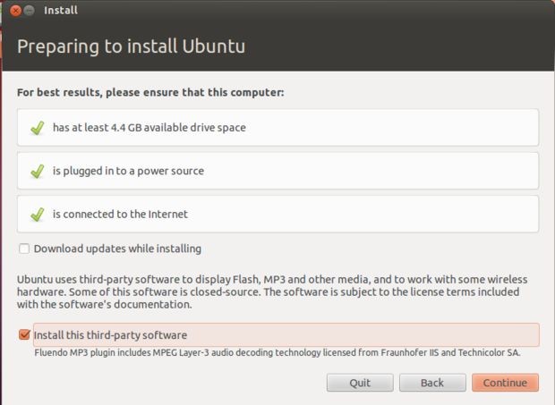

When you are ready to carry on, double click the “Install Ubuntu” button on the desktop to start the install wizard. Make sure you put a check in the checkbox next to “Install this third-party software” as this is needed to use MP3’s. Continue following the install wizard until you get a message that your installation has completed. Switch off your computer and remove the installation media. Switch the computer back on and you should have a choice between booting up in Ubuntu or Windows.
